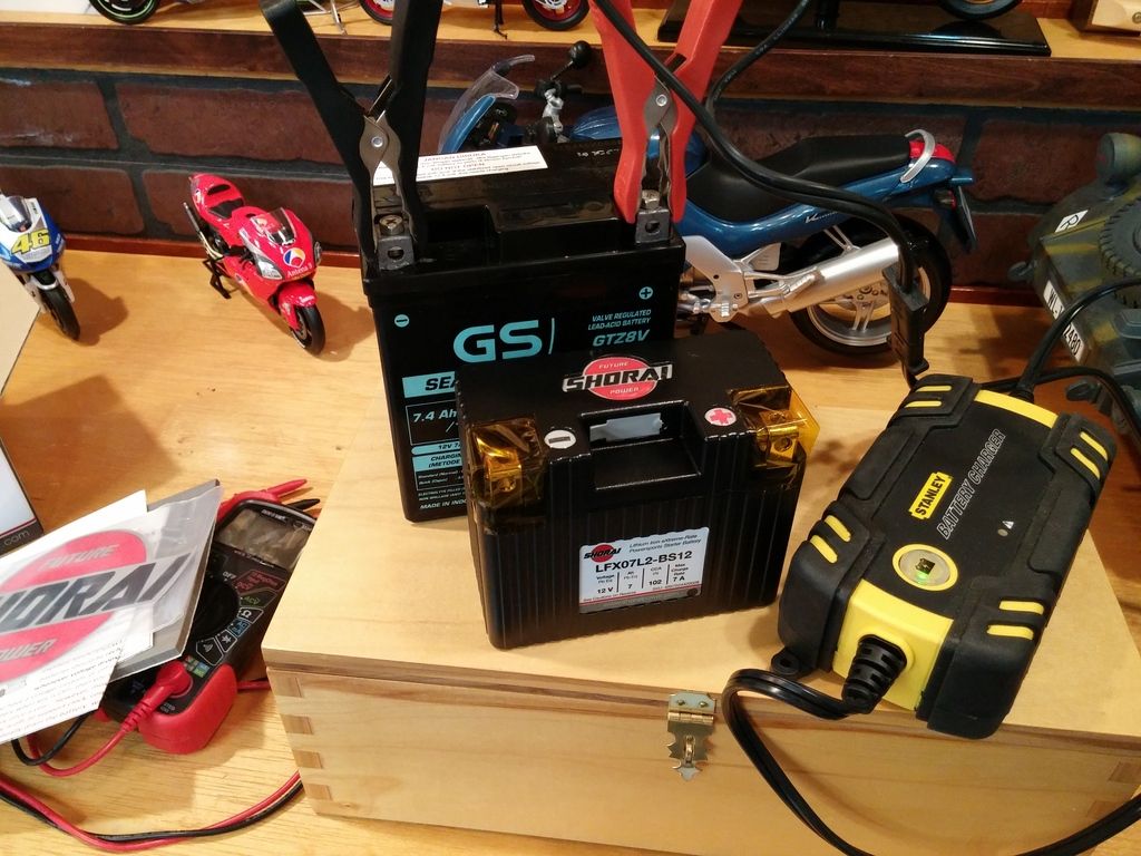

I can't find the thread on here about someone's battery dying on the road and "maybe the dealer didn't charge it", but after reading it a week or so ago, I went down and removed mine while paint was curing on plastic parts. It read only 10.4 on my digital multimeter, so I charged it for several hours on a simple charger; it read 12.9 right after removing it from the charger, but began to fall right away. It went back down to 10.8 in a few hours just sitting on my bench. I've charged it again several times for 2-4 hours with the same results. Isn't it supposed to stay around 12.4? Both my other batteries keep a charge for weeks.

If the battery is losing nearly 2 volts just sitting on a bench for a few hours it has an internal short (bad plate insulator) in one cell. This you would think would/should be covered under warranty.

It's made in Indonesia along with the bike. I'll just replace it with one from Shorai like on my other two bikes. A warranty replacement means two long drives to the dealer; I'd rather just get a lithium iron unit shipped to me. At least I know about the battery now, before getting stranded...
When I bought the R3, I was planning on replacing the battery with a Shorai lithium iron battery after about a year of using the factory battery, but this crappy factory battery just made the purchase happen a bit sooner. Already on the way to my house from Amazon. $87.00 for the Shorai LFX07L2-BS12 battery if anyone else is looking to replace their factory unit...

It was delivered a few hours ago:
Smaller than factory battery and weighs less than a pound! Shorai includes plenty of self-stick firm foam sheets of various thicknesses to fill-in the space in the battery box.

How much does the stock battery weigh? Wondering how much weight savings there is with the Shorai. I have a shorai for my car and I save a whopping 35lbs over stock!
I don't have a scale, but the stock battery feels like 6-8 pounds maybe (using some exersize weights as a comparison).

2734 grams - or right at 6 lbs.
