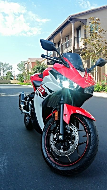

10000k HID OPT7 off of Ebay! 39.99 Cant beat it! And they have worked like a dream.
it looks awesome! do you have a link on ebay which one you bought? and did you install it yourself? i am not very handy and i am wondering if you can install it yourself.. thank you!!
