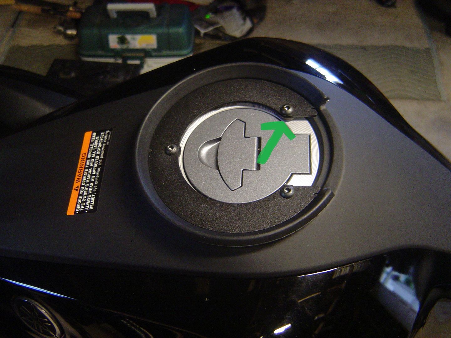

I measured and drew out the R3 filler dimensions and will compare it to other Yamaha models at the dealership tomorrow. In the meantime, I noticed that the bag you bought is a clone (or re-badged bootleg) of a GIVI model, 3D603. On eBay for $120 shipped, so you saved $15. Score....
I think the GIVI fitting kit is the BF05 but will verify tomorrow.
See photo:
This means all GIVI and KAPPA Tanklock bags will also fit your ring mount.

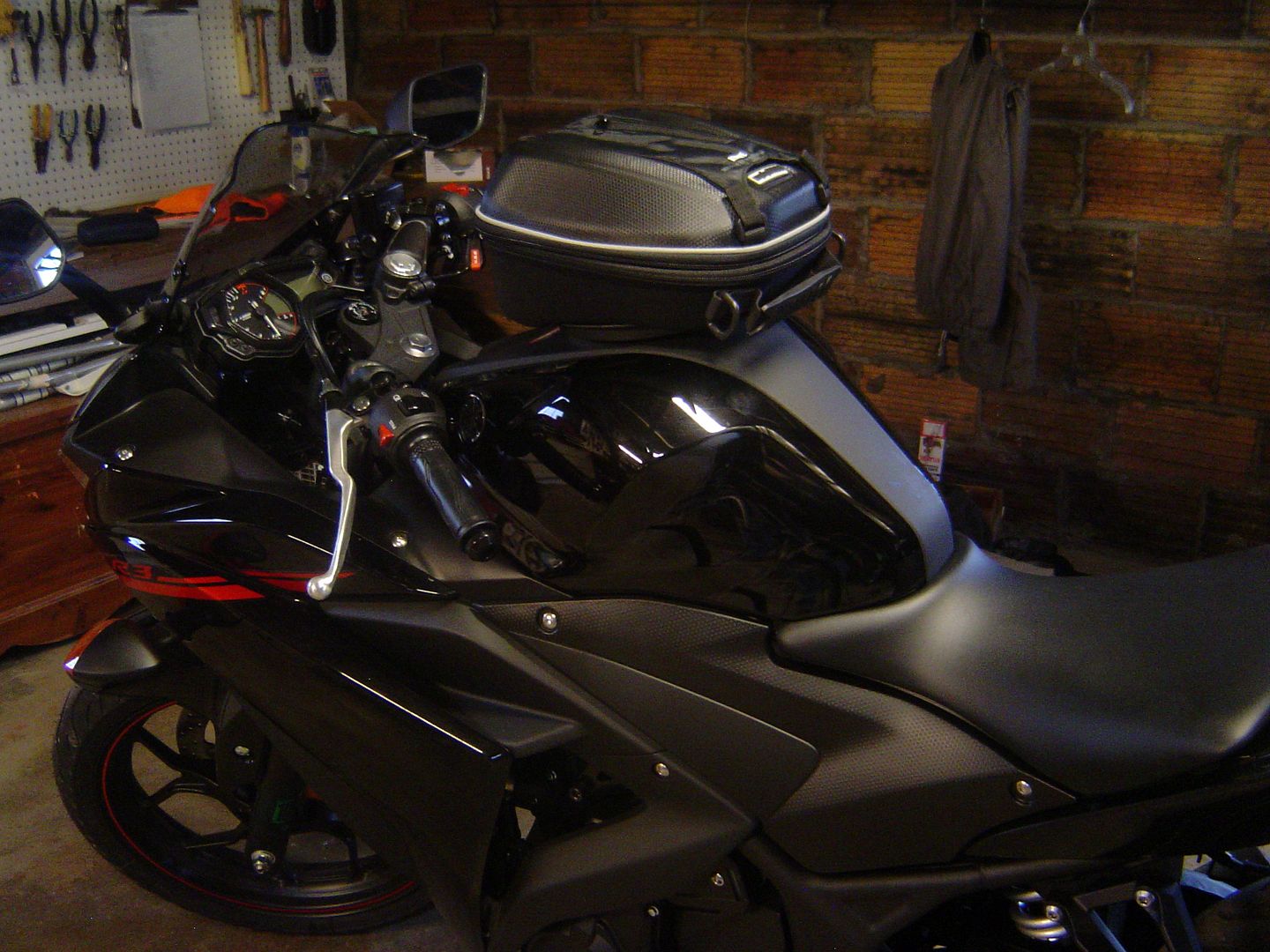

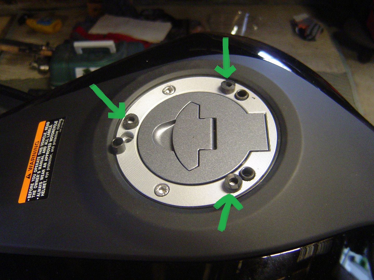

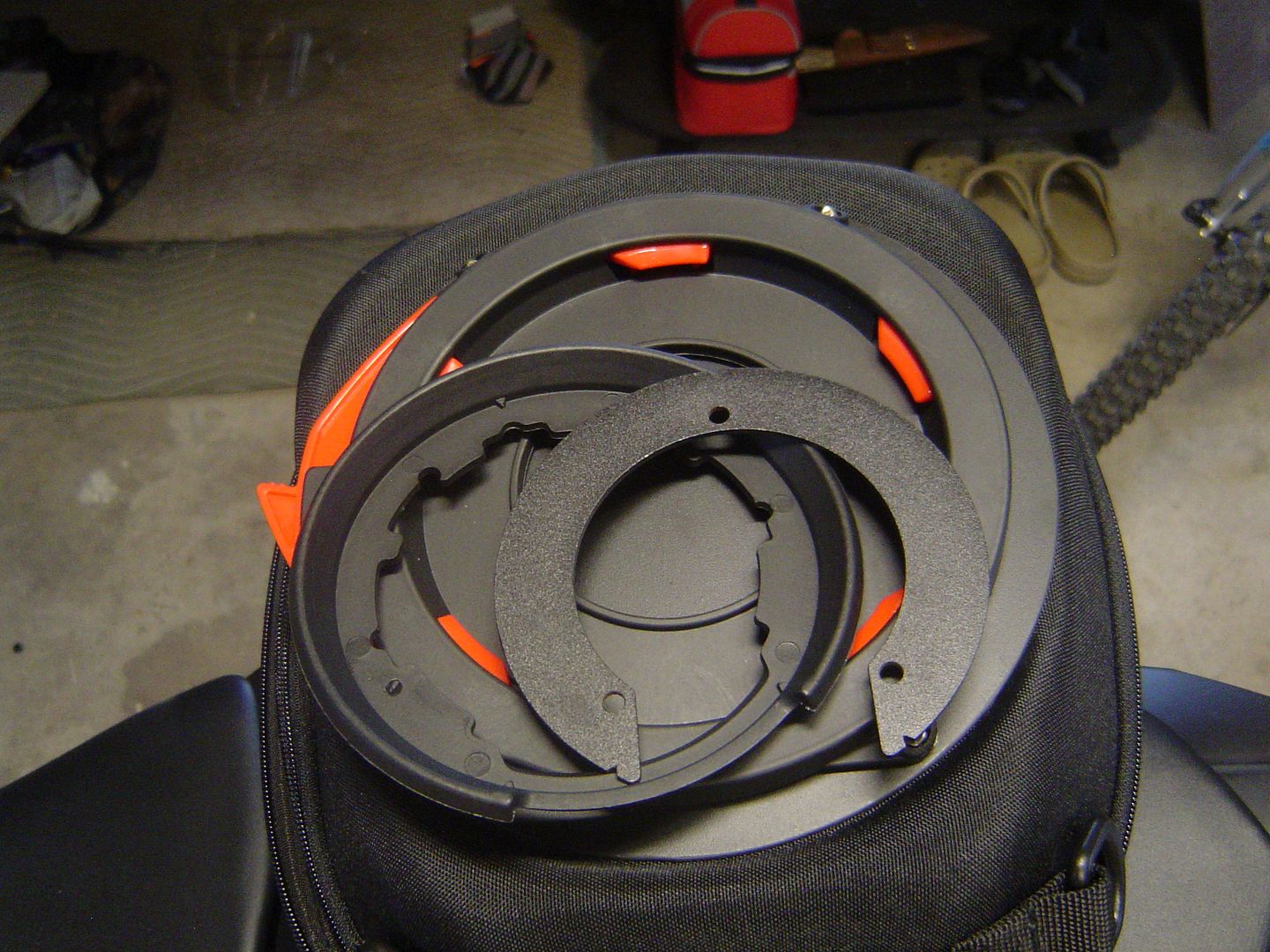

I got the tank bag today, it's a re-badged GIVI. Seems like very good quality. It bolted on with very little problems, everything lined up perfect. I had to make one minor adjustment, had to add three rubber washer (I cut them from some old fuel line hose). It didn't come with any directions but it took very little to figure it out. It's very simple and snaps on and off very easy, yet holds very secure.
Doesn't hold much, but perfect for quick trips.
I cut the rubber washers to snug things up.
You can see here where they were needed.

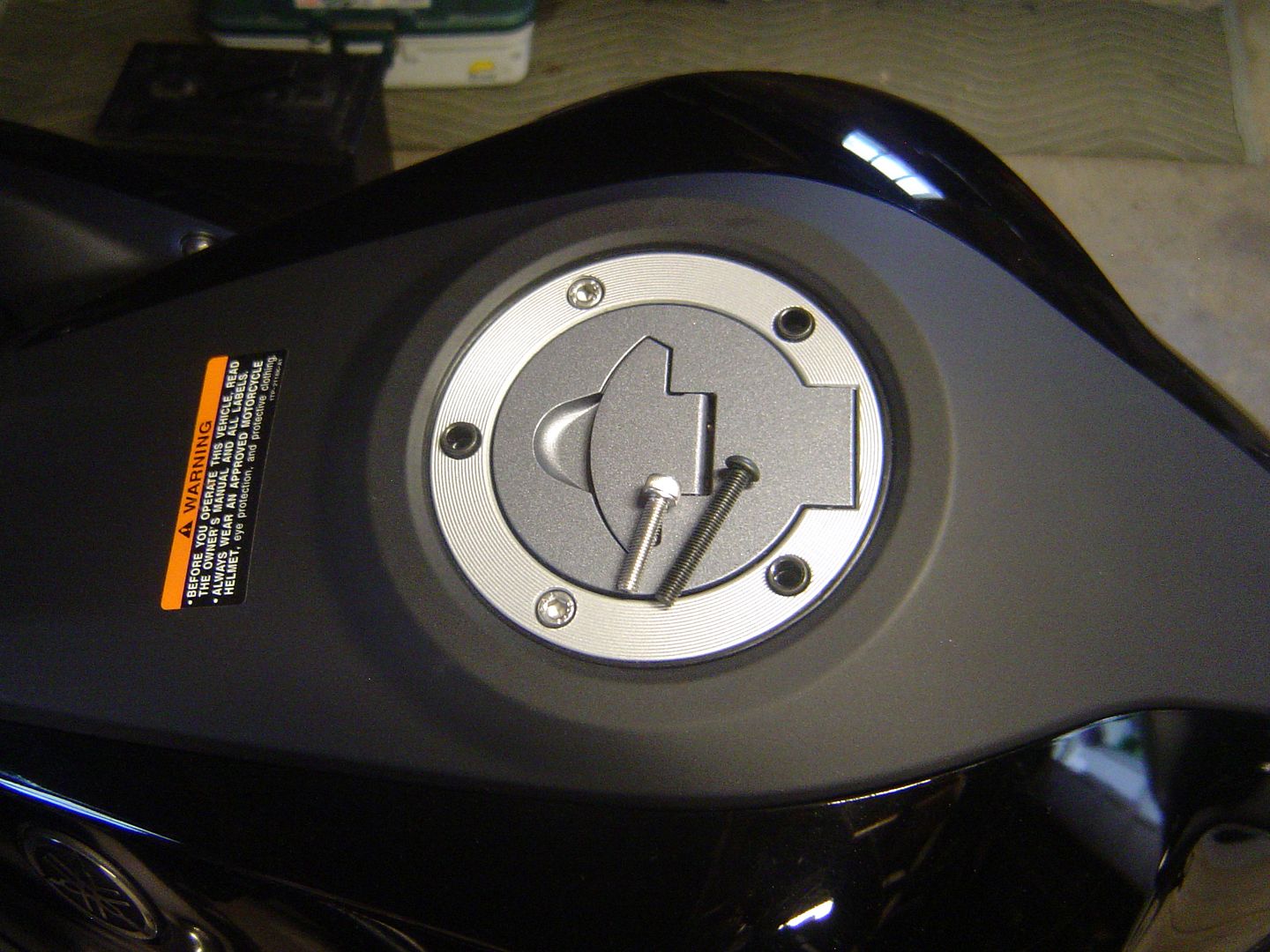

I got the ring today and tweaked the holes to fit the filler.

I had the same problem with them so I just took a chance and ordered their Yamaha ring.
Here's all the info from my post....

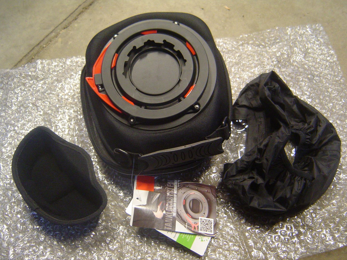

GIVI Tank Bag
I received the GIVI TankLock XS319 Tank Bag today. Had it installed in less than 10 minutes.
It came with a Hi-Viz Rain Cover and a clip-on carrying strap.
This one is only 3 liters, but actually carries a fair amount of stuff.
Because I understand Murphy's Law of Stuff, "The amount of stuff expands to fill the available space", later on I'll buy a larger GIVI (or KAPPA) tank bag (15, 20 or 25 liters) so I can swap them out depending on how much I want to carry.

Nice tank bag. I noticed you also added a few washers to make the fit right, I did the same. I put the new bolts in with a bit of blue loc-tite. Since I got my tank bag, I really haven't needed more space, just the basics for the type of riding I do and these small tank bags are perfect to keep your pockets empty and add a few items while on trips. I love how easy and simple the locking system is. Taking the tankbag off and just setting it back on and it clicks right on.
