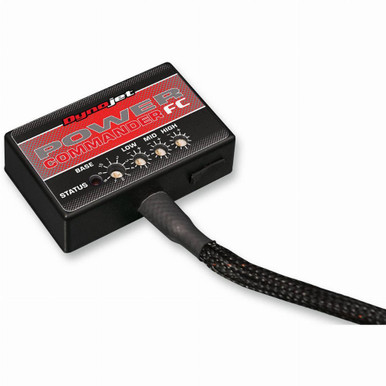

I was looking at buying a PowerCommander FC (NOT PCV) just want to know if anyone has used one on an R3 and what there experience was with it. I know the main difference between this and the PCV is that you cant add stuff like a quickshifter which is fine in my case but I was just wondering if there is anything other differences im missing.

I purchased the bike used. The previous owner had installed a Yoshimura R-77 full exhaust on it, as well as some cosmetic mods. I installed a K&N high flow air filter and the PCFC. I only purchased the PCFC because I was concerned about the bike running too lean with the full exhaust and the stock fuel mapping. Whether it was running too lean or not is unknown but most of the comments on this site as well as others cautioned that installing a full exhaust without doing anything to the fuel mapping was a bad idea and might damage the engine.
After installing the PCFC and selecting the Dynojet fuel map for the R-77 full exhaust, the bike runs fine but I haven't noticed any significant improvement in power or throttle response.

The PCFC will access the same fuel maps that are available for the PCV. So Dynojet's claim is correct as far as I know. Regarding the lack of change in power or throttle response, I should mention that I don't race my bike. Perhaps if I took it to the racetrack and ran it a full throttle I might notice an improvement. But I ride in the city and on the freeway, and in both cases, I didn't notice any change, at least nothing significant. Keep in mind that all you will get with a full exhaust and fuel mapping is 2-3 HP gain which will be subtle, and that is with a custom fuel map developed on a dyno for your specific bike, as opposed to the generic map from Dynojet that they developed for their bike. There are other fuel mapping options such as getting an ECU flash which provides more than fuel mapping and may unlock some additional power gains - I can't comment on that because I haven't done it myself.
As I mentioned above, when I purchased the bike, it came with a full exhaust. If it were me, I would have installed a slip on and then not bothered with additional $ for fuel re-mapping.

Keep in mind that when I purchased the bike, it already had the full exhaust installed. I've never ridden this bike with the stock exhaust. So my comments about not seeing any noticeable improvement in power or throttle response are comparing full exhaust without power commander vs full exhaust with power commander. That's all I can compare. I have no doubt that going from the stock exhaust to the full exhaust greatly improves the fun factor.
