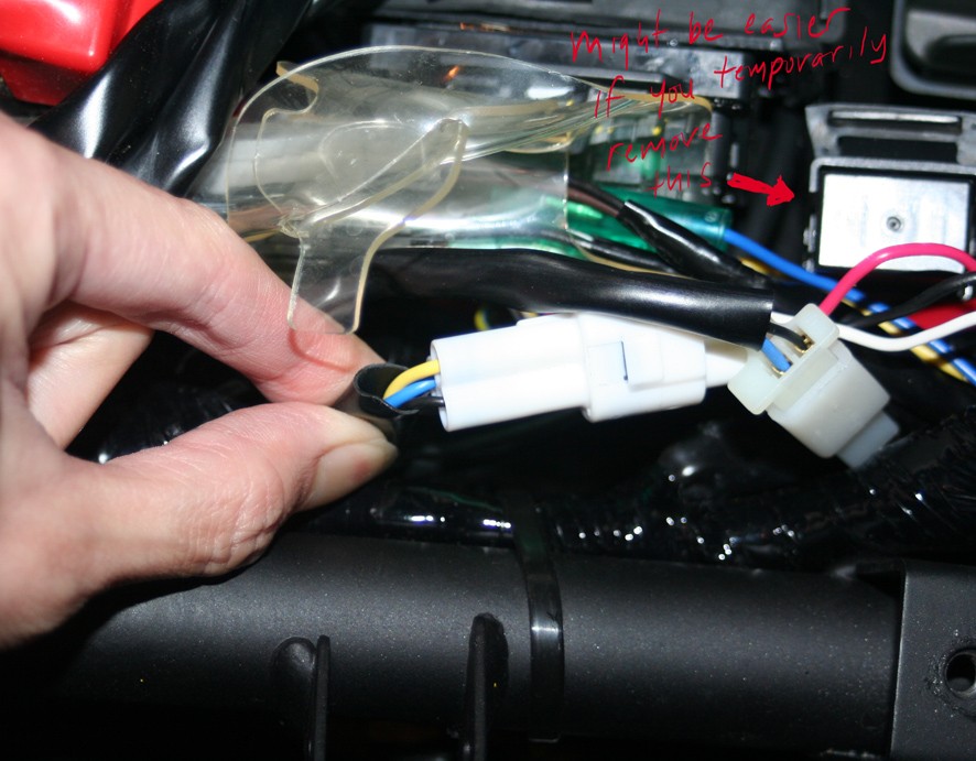

Hey, I just got my Supabrake II in the mail and I'm not quite sure where to hook it up. Is it the clip under the passenger seat?
Thanks!
Thanks!
Its the 3 prong white connector, the biggest white one buried under all the wires (the thing I'm holding in the pic).
You may have to remove the big black square to get easier access, it just easily pulls off and you push it back into the 2 clips.
And I should mention, on default profile setting (which you can change), the SB2 "resets" the moment you power on the bike, so it does not modulate until after 12 seconds. The minimum you can change this delay to is 6 seconds which is the aggressive profile.
I mention this so you'll know to wait 12 seconds before you test out the modulation after you turn the key.
Thanks!
I neglected to say that it is under the main seat, not the passenger seat. So after you remove the passenger seat, unscrew the divider that is between both seats (2 allen bolts- I believe the tools that comes under the passenger seat in the plastic pouch has the necessary allen wrenches), and then remove the main seat using 8mm wrench or ratchet. Not sure if the motorcycle tool pouch has this or not. Your battery, fuses and all the wire connectors for the rear are located here.
Awesome! Thank you Lollingthunder. All is working correctly now.
